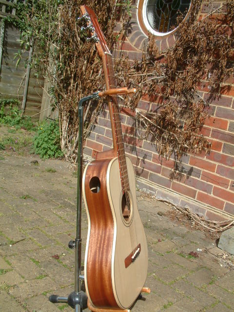

No I didn't sand back to wood. I mixed a small amount of Z-poxy and using a piece of paper kitchen towel wiped a very thin coating all over the neck. Then when it had dryed the next day I rubbed it back with 0000 wire wool. This takes quite a while to do but eventually the wire wool levels out the Z poxy leaving a really smooth finish. The Tru-oil was then wiped on in thin coats as I normally do using more kitchen towel. It was a Spanish cedar neck and part of the reason for using the Z-poxy was to match the colour better to a sapele b/s that had Z-poxy on. I don't have a close up picture of the neck but this is how it looks on the guitar:

Beautiful, Dave! Thanks so much. I'd like to try something like that.
Seems like the z-poxy might add some durability as well.
